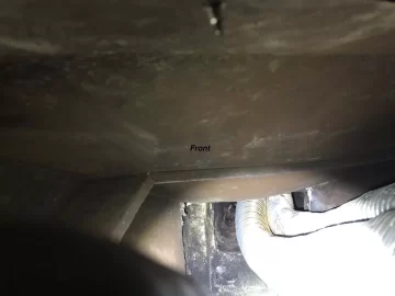

First photo is 22 years ago, along with direction that the chimney goes. Dropped floor has been raised. 2nd photo size of room without the eat in kitchen (to the right) doors to the left go to an office and to the front entry (leading to upstairs), 3rd photo is what we are seeing and wondering if we can go straight up from a stove pushed partly in.
