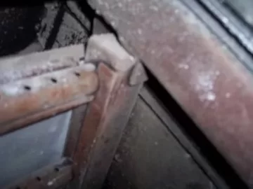

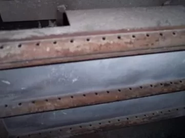

I started running a Hearthstone Homestead Dec this season. Today I noticed that the front secondary burn tube split clean in half the whole length of the tube. It is still held in place by the cement or whatever on both walls of the stove. The gap is probably an 1/8 to a 1/4 inch. Maybe that's the way it's suppose to be and I never noticed, but the other two behind it are not split. Stove was running alright.
What do you reckon?

I must be blind cause I don't see any split? If your talking about on the bottom of the tube at 6 o'clock, that is the bottom of the deflector shield where it wraps around the tube.
Yes, the split is at 6 o clock . . . hadn't noticed before. If that is the way it is constructed, that is great news. Like most of you guys, I am boarderline obsessed with this stuff, so it suprised me. You call it a deflector shield, to deflect heat? the impact of logs when loading? Any other opinions.
Thanks.
My stove looks exactly like yours in the picture,that front tube holds the deflector in place, if you remove the tubes the deflector will rotate to the rear and lay down flat on top of the baffle board. That is how I vacuum on top of the baffle after I sweep the chimney.
When the stove cools off you can reach up there and wiggle that deflector to verify. My deflector is cotter pinned to the front tube. Also the baffle is cotter pinned to the middle tube in two places. Tubes seem solidly fixed in that cast iron manifold.
Stove has cooled somewhat . . .
Can't see the pins, but stove is 275 degrees right now. Only the front tube looks "split" from 1 end all the way to the other end, length wise.
I can wiggle the tube a bit back and forth with a gloved hand, but it is definitely fastened good where it meets the brackets on each end.
Doesn't look split a all to me. Looks like that piece of metal above the tube wraps around behind it. It overlaps the bottom of the tube. You are just seeing a shadow. The NorthStar and 7100 now have a very similar setup to keep the insulation blanket from bunching up in the front.
now that i see the pictures i get it , the tube is "nested" in the bracket that runs behind it , at a glance it looks like a split , but i look closely it is not the tube that makes the "split" look, but the seam behind it from the bracket , looks just fine to me
