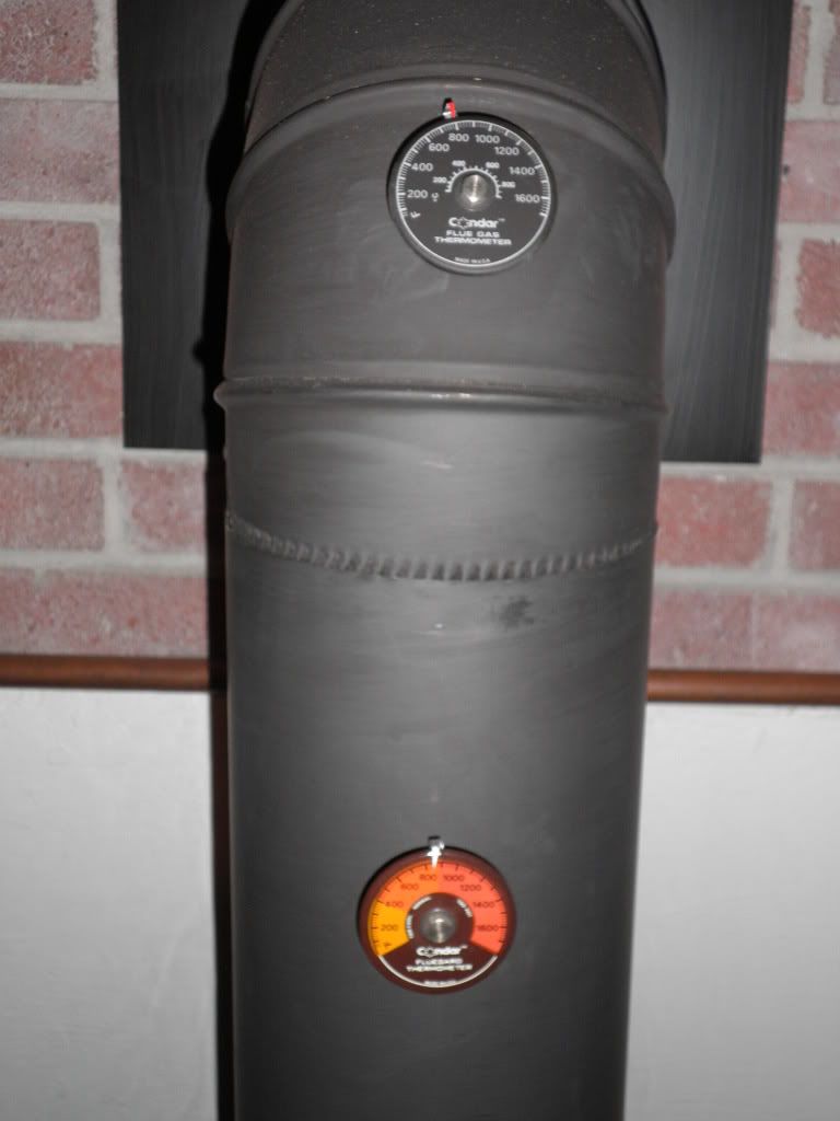

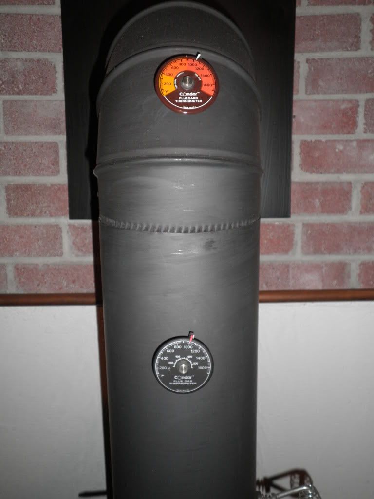

3-39 Condar Probe vs. 3-19 Condar Probe. Test Results.

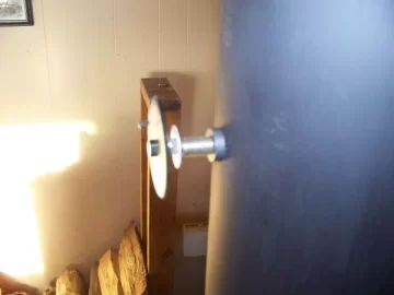

That little eyelet allows you to pull it out and still be stable. I made a 1" spacer for my probe and now it's reading like their claims.

The spacer looks good. Maybe they could simply include one of those to fix this problem the easiest. Although I would perfer it to sit flush.

Here's the new 3-19 I received from starbrickstoves.com.
It does read lower than my 3-39 probe, but only 50 degrees less, not 200 less like BeGreen's did.
So, now we have to guess whether or not components changed again even within the 3-19's? Or even w/ light/moderate use has BeGreen's lowered in temp a bit over time? Or is there this much variability/uncertainty in any probe that you can buy?
What I find interesting is that all of the thermometers read identically below 450 degrees.
Condar claims 4000 hours use is it for these things. That's basically 1 season! Have our thermometers changed over time and we just not notice it?
We need someone w/ double wall pipe to do testing like I have here to compare.
Sorry that these pics aren't as high a quality as the others. This is my wife's camera. It's 5 years newer and a few megapixles more worthless.
pen
