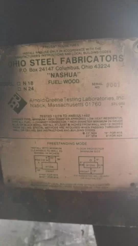

So I'm a big fan of Nashua stoves and we decided to downsize our stove from a larger version that was previously in the house. I picked this little gem up from my neighbor for 50$! I thought it was a steal. Its in great condition.
Now the hearth on the other hand is in not so great condition. Its cracked, uneven, ugly, and not up to code. I'm going to remove it and build my own hearth pad. I have yet to ever see a manual for a Nashua wood stove but all of the Nashua stoves I have had, have all had the plate on the back that describes UL testing and all of the required clearances. The plate of this stove says the floor protection is just "3/8 in. asbestos millboard or equivalent"
