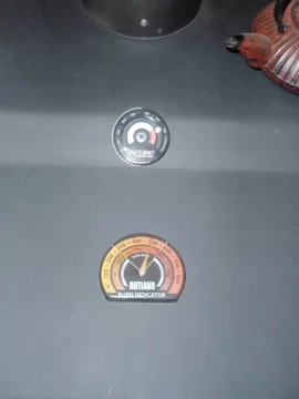

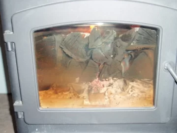

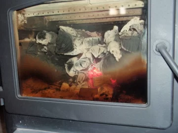

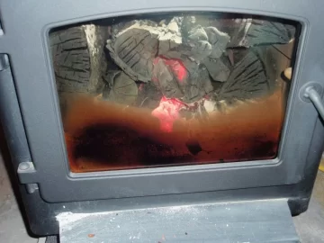

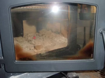

The PICs are in order of how the glass progresses throughout the burn cycle.
I start with crystal clear glass and all stays good until I close the primary and the secondary burn kicks in.
Then (as you can see) the glass steadily forms a "U" shaped brown haze on it.
The brown is darkest at the bottom and not opaque, but rather transparent (sort of a root-beer color)
During the coaling stage the brown seems to burn away somewhat, but never completely. (see last pic)

Try leaving the air control open just a touch more,,,, extra 1/16-1/8 inch
When you close the air control, what you are doing is cutting back the air wash air.
For me, I get a white haze on the door if I put a piece of wood right in front of the dog house air. If I leave a bit of a gap between splits in front of that air inlet, things stay much clearer.

I get no brown on the glass unless I shut the air control too much. Not even with wet wood. You are simply running her too low to keep the glass clean. Might be a necessary evil for your install.
