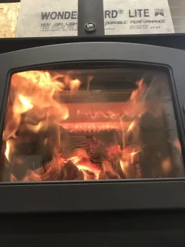

Here’s my nc30 this weekend. Pipe surfac temps under 300, glowing baffle and tubes. Stove temp about 700. This “the zone”!
Thanks, Highbeam. As I said my wood is too wet, but the other day I must have found the dry spot in the stack and I found out this stove loves to cruise right at 700 or so. All the glowing parts just had me a little freaked out.
