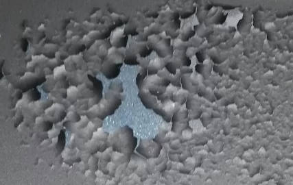

Well now I have another problem forming. Damn it this stove is awesome but causing me way more headaches than I need.

That is the top of the stove right by the pipe collar. A little behind the pipe collar. What is going on now????? Now I'm just about fed up with this unit. Great stove but now I'm getting aggravated.

Excuse me no. That stove never goes above 650. I'm not overloading it because I'm scared of putting too much wood in and overfiring it. Never goes above the firebrick either. I need to know how to get another stove and not pay any charges for this problem. I'm an upset customer.
Bummer. That's pretty uncommon for a new stove. Could be that area was contaminated before painting or a bad batch of paint? Time to call Englander support.
Scrape it off, sand and spray a little high temp black on it. Fixed!
You get what you pay for. Cant expect the quality of a BMW from a Hyundai.
For close to a grand it seems reasonable to expect the paint to stay on.
Thanks for sticking up for me lol. Can't believe u just said that. Read reviews bro. One of the better stoves out there
Anyone who's watched this forum knows that Englanders quality is not the best. From Madison springs to whining blowers on pellet stoves there are numerous threads on poor quality with these units. For a low end stove, they're not bad but they do have quality issues. Just saying buyer beware.
I installed mine a month or two ago and have burnt it about 10 times or so and I love mine. Yours may have been made on a Friday or a Monday morning lol. It's easy to get a lemon with anything. I believe I'd just scape it and wipe it down with acetone and hit it with some high temp paint. Mine draws so hard I'm afraid I'm gonna have to close some secondary air off. I'm sure englander will take care of you if your that unhappy with it.
Sure, it's a "value stove" but the paint shouldn't be an issue, like begreen said. Definitely contact them; Englander is known for great customer service.
I don't blame you for being upset.That should not happen with a brand new stove.I had mine for 3 years and burn 24/7 from dec. to april and I have had no problems at all with mine.i would send it back.
