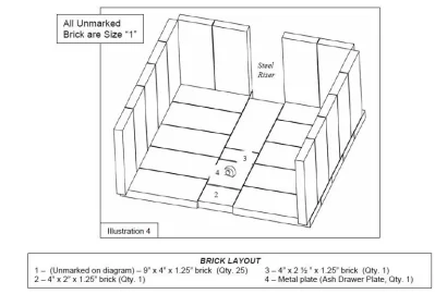

    So, when I moved the 30 I had (what I thought was) the good sense to take the firebricks out, knowing there was a diagram in the manuals to put them back in whatever order they came out.
    On installing it, I found that no matter how hard I tried, I ended up with a gap at the front of the floor that was less than the required 2 1/2" for a standard brick AND I had 2 bricks left over that evidently should go there AND there were no other narrower bricks anywhere else in the stove.
    So, I just sort of leaned those bricks in place as far as they would go, in the gap to either side of the doghouse.
    Now, I can cut these bricks down to make them fit... not worried about that.
    Two burns have indicated this may have messed up the airflow, since if I shut the door fully, even with the air 100% open, the flames die out and temp starts to drop. If I crack it open 1", kaboom, everything flames and temp rises.
    Am I reading this right?

    blue, I don't have a 30 but on my stove the very front 2 bricks have to be put in before the bricks further back because they actually slide under the steel lip inside the door opening. I took a quick look at the 30 brick diagram and as long as you put the bottom bricks in before the sides and the rear, since the sides and rear sit on top of the bottom bricks, this is all I can think of. Also make sure the rear bottom bricks are slid all the way to the back of the actual firebox past the steel air riser in the middle back. Good luck and hopefully someone with a 30 can chime in and pinpoint the issue.

    Ah, never thought of that... when she cools down I'll rearrange 'em.

    Page 10 of the owners manual shows the layout. owners manual

    Did you get the brick set in correctly?

    Haven't redone the bricks yet b/c it's been burning all day... that's tomorrow's project.
