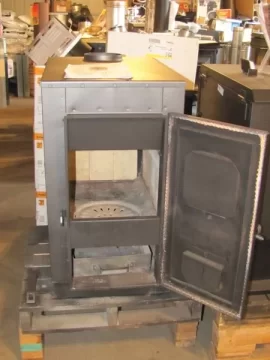

my location is on top of the Tug Hill in NY 6-11 foot of snow is not unheard of. down in the -40's at times. 30 yr old double wide with chit insulation. and im well beyond doing any more upgrades to the house.. to old and it wont benefit me.
old shenandoah
very similar to this one.

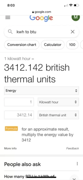

If the OP subtracts the kWh used in the summer from his winter usage he’ll get close to his heat need. People generally use more lights s as nd such during the winter. He can convert the kWh to btu. From there he can calculate the amount of pellets he would have needed.
