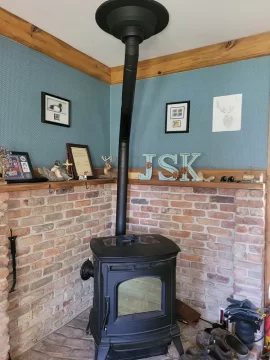

I have 3" insulated stove pipe from stove to ceiling going into a 3" - 4" adapter that was is attached to my existing 6" insulated woodstove flue pipe going thru attic and roof. It is about an 8' run of 4" flexible pellet flue inside the 6" insulated flue sealed on top. I have had no issues with draft or otherwise. I do clean it 2x during winter just bc I want to make sure ash doesn't build up at bottom of flue behind the stove.
