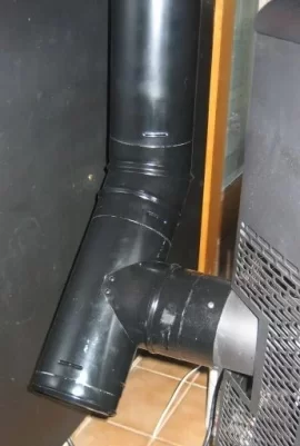

just want to make sure I got this...this picture shows my pipes, my stoves pipe ( 2 3/4") just slides into the silver exhaust pipe( double pipe, inside is 3"). I need to get a metal pipe adapter that will slide tightly over my stoves pipe, and slide tightly into the silver exhaust pipe thus making a tight fitting on both ends...correct? Or can I just get a clamp and tighten that down on it.
[Hearth.com] Appliance Adapter - Necessary ?
I see the need of the adapter.....

  • [Hearth.com] Appliance Adapter - Necessary ?
chrisasst said:
just want to make sure I got this...this picture shows my pipes, my stoves pipe ( 2 3/4") just slides into the silver exhaust pipe( double pipe, inside is 3"). I need to get a metal pipe adapter that will slide tightly over my stoves pipe, and slide tightly into the silver exhaust pipe thus making a tight fitting on both ends...correct? Or can I just get a clamp and tighten that down on it....
The appliance adapter is slid over the exhaust pipe from the stove, and attached with 3 sheet metal screws (see the pic I attached above), then the pipe or T or whatever you use turns and locks onto that.

The appliance adapter has a rope gasket at the bottom, so when you insert it onto the stove outlet, the exhaust pipe seals against that....I didn't use any silicone, and had no leaks that I know of. I slid the adapter onto the exhaust pipe, pressed firmly so I knew it was against the gasket, and held it in place while I drilled the first hole for the sheet metal screw.
