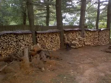

PS: Here is some of my maple for this year...
  • [Hearth.com] 4 Year old "Intrepid II"
