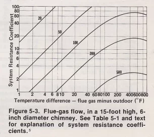

I general, I agree with what you are saying. However, in warm weather there is not much temperature difference between inside and outside air. Draft can be non-existent, or even reversed. Rapidly burning materials such as newspaper will need very little draft to burn, but the heat generated will rise up the flue and warm it up enough to jump start the draft. That doesn't mean it will be strong, however. A closed stove has a lot of internal resistance. The intake alone on some stoves presents 4-5 times the resistance of the entire chimney. With a cool flue there isn't a strong enough draw to get the air through all the openings and channels, plus all the passages between the splits. A slightly opened door will reduce this resistance to a fraction of what the closed stove has, and the fire will take off easily.
All that said, I virtually never have to resort to that "trick", even in the shoulder seasons. I start the fire with the smallest of kindling (match size) and quickly work my way up through the sizes until I am adding splits about 1 1/2 - 2". Once they are going well, I close the doors. I can almost always hear the air velocity pick up withing a few seconds, and I'm good to go. Flue temps are usually close to 200º by then, so an adequate draft has been established. Five minutes later, I'll come back and I have a small bed of coals to build the fire up on. Flue temps will be up to 500-600º by then, so at that point, the warmer outside air becomes irrelevant to the strength of the draft.
I burn in a pre-EPA stove, so I don't have all the baffles and burn tubes and all, so there is less internal resistance in my stove than in many newer stoves. Seems the new stoves need a boost from the cracked door more often than the older designs do. However you do it, you need to establish an adequate flue temp as quickly as possible if you want a trouble free startup. How hot? These two graphs will help you figure that out. Consider that the resistance coefficient of your chimney itself is likely to be in the neighborhood of 4, whereas the closed stove can be as high as 20 with the bypass damper closed. By comparison, an open door cuts that number down to about 2. A cracked open door is somewhere in between depending on how far it is open.
