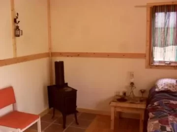

Thanks for the input - I ended up going for the jotul - i liked its fit and look in the cabin - although the pyropak looks like a good little stove.
So far the jotul does overheat the cabin - so I have to keep small , sporadic fires to keep a decent temp - but I may add another extension onto the cabin in the future and the stove can definitley handle it. Attached is a pic - prior to stovepipe being installed.

Nice! Hope it keeps your little slice of heaven warm and toasty.

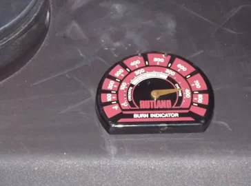

I think the fan should be fine. The top of my stove is reaching 700F. Mind you it's windy here this evening, but that's with the draft closed all the way...
See pic attached...

tominator, I need to get one of those thermometers. Curious to know...what would the average operating temp range be for your pyropak?
I normally don't have that thermometer sitting on the stove top. Instead I leave it about 16" or so above the top, attached to the stove pipe. Much of the time, it hovers around the 350-400F range at that height/position, at least until it has burned down to a bed of embers. My guess is that the stove top averages between 400 and 500. I'll do some testing to confirm. As you probably know, the "hollow cavity" in the top of the stove that's used for the secondary combustion air (intake in the rear) helps the top not get too extremely hot. When I took that picture last night, the wind was howling around 50 mph outside. Even with the draft closed off completely, the wood was burning fast. I have no damper in my stove pipe...
