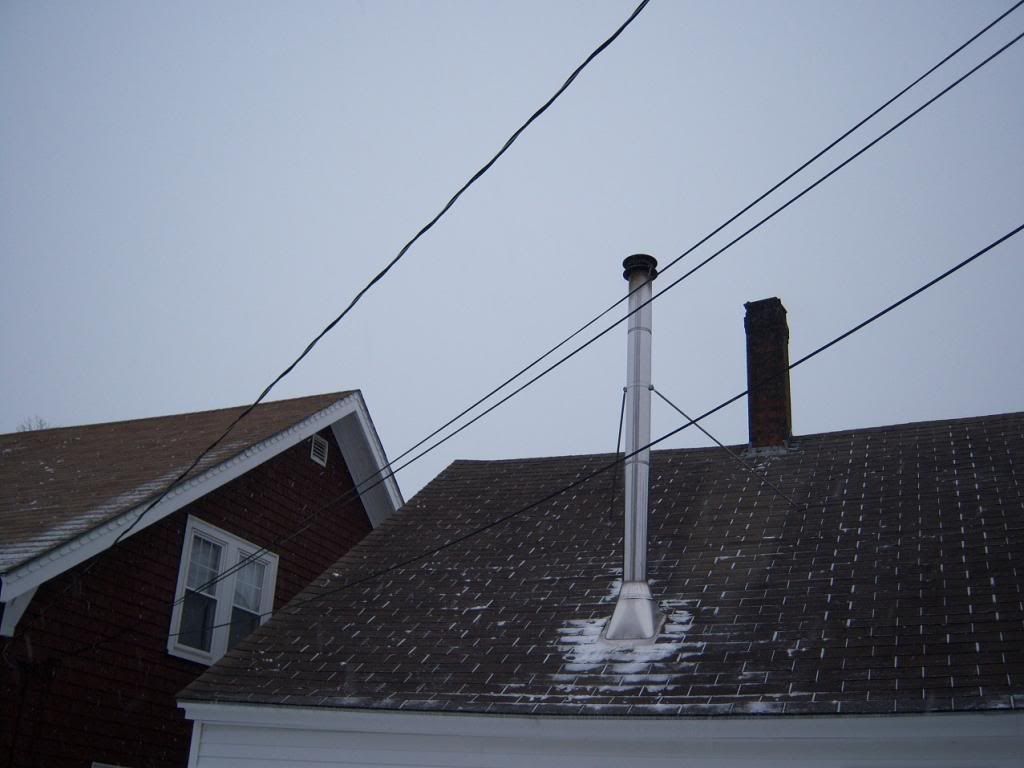

  6. Bub381
    Bub381
    Feb 4, 2011
    872
    41
    Mid-coast Maine
    I'm thinking as Charly is.I just rechecked and this is not above the peak it's just about level with.It is however 10' from the peak measured horizontally.

  7. EatenByLimestone
    EatenByLimestone
    Jul 12, 2006
    5,896
    675
    Schenectady, NY
    The wing was just right... Sometimes it causes a problem when the flue is cold like on a reload. I had one that had a tough time lighting off today.

  9. Jon1270
    Jon1270
    Aug 25, 2012
    2,043
    1,147
    Pittsburgh, PA
    Sounds like it's 2' shorter than it should be. The rule is, 2' above anything in a 10' circle, no?
  10. Bub381
    Bub381
    Feb 4, 2011
    872
    41
    Mid-coast Maine
    I'm glad someone is thinking because i sure haven't got my head on straight today.I believe you're right it may be level but not 2' higher but other than this having to be done to meet reg's,will it possibly cure my problem and believe me it will be done to reg's.This is 2 things i've found wrong with this installer.This pipe is gonna be awfully high,prob need another set of braces.
  11. Casrep
    Casrep
    New Member 2.
    Feb 18, 2013
    3
    1
    Before you spend any money, check the screen on your cap. I had the same problem until I removed the clogged screen.
  12. begreen
    begreen
    Mooderator 2.
    Staff Member
    Nov 18, 2005
    65,891
    8,907
    South Puget Sound, WA
    Agreed, start with the simple solution first. If you find the cap screen and pipe are pretty clean and this is a frequent problem, I would consider getting a revolving rain cap like this:

  16. Bub381
    Bub381
    Feb 4, 2011
    872
    41
    Mid-coast Maine
    This happened during a roaring fire too,i could see it's effect as it went from a lazy flame during gusts to a roaring flame during the wind let up.This house i believe is uninsulated being built in 1800 but is vinyl sided.Yes the insulation is going to be done but i had to get the stove when i did.No doors were opened,i was the only 1 home and was sitting on the couch as it happened repeatedly.No dryer going or anything,i opened the windows after to air the place out and it seemed to actually help.It was blowing 55 at least.It didn't happened when the wind calmed down to say 30 mph or so.Also as i said,it has blown this hard in this direction before but i will check the chimney though i cleaned it very well myself about a month ago.
  17. embers aplenty
    embers aplenty
    Burning Hunk 2.
    Mar 17, 2011
    118
    32
    East Tennessee
    I'd say, check screen on the cap, and maybe try the revolving rain cap or the vaccu stack deal. If that don't work, then another section of pipe would probably be in order. 55 mph wind sounds pretty stiff. I normally try to let mine go out if it's that bad. But freezing to death and having to turn on electric would be a drag too.
    Looks like if you add another section of pipe, you'll most likely be putting some more braces up higher, especially with the wind your experiencing. You sure wouldn't want it to buckle on you. You'll get through it I'm sure. :) That wind has been pretty rough lately. We got one of the worst wind storms I ever remember in these parts about a week ago. It was a fight to keep all my nicely placed metal on my wood stacks from blowing down the holler. I've been thinking about getting some 2" x 30' ratchet straps. Just hate to pay for them. I can feel your pain.
