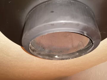

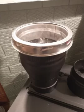

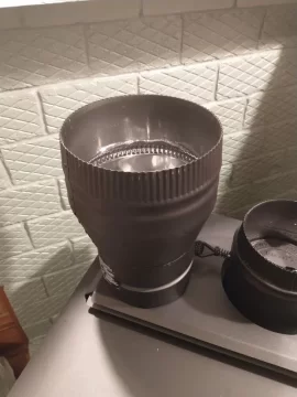

Good evening all,
I've been itching to get my stove installed but other commitments have kept me from it. I'm at what seems to be an impasse. I have 8" metalbestos chimney pipe and it appears to me that there is not a chimney pipe adapter connected to the first section of pipe above the finish support. I'm going to put a 6 to 8 inch increaser at the support but don't see how it can be connected correctly without the adapter. Am I missing something? Is there another way to adapt from double wall stove pipe without a chimney pipe adapter?
I picked one up as you'll see in the photos, but I'm really hoping that I won't have to tear the chimney down from the roof just to drop that piece in 😣.
If that's the case, how could the previous owner of this home have used their stove without the adapter?

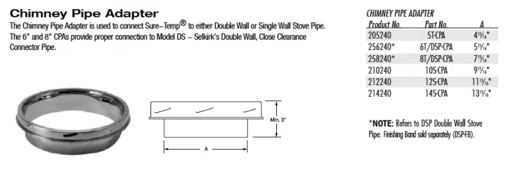

It looks like the ceiling support is their 8T-FSPR model. I haven't worked with this pipe, but the catalog shows this adapter:

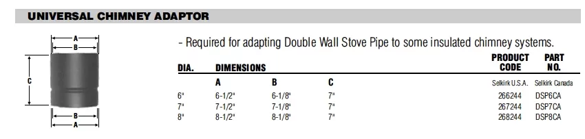

Selkirk sells a universal chimney adapter. Here are the dimensions.

Thanks for the reply. The ID of the support is only 8.25" so looks like the universal adapter is out since it's 8.5" for the 8" unit. If the catalog is only showing those two options then I guess my only option is complete disassembly and reassembly?

It looks like there is an inner liner, inside the support and an outer collar. I would think that an adapter would slip between the inner and outer parts. Have you tried calling Selkirk support?

Called Selkirk over lunch today. Chatted with a tech named Sean; super helpful and had the answer for me instantly after describing the issue. He recommended using the their "stove pipe appliance adapter" PN 258245. He said that is their retrofit solution for systems that were not installed with a chimney pipe adapter initially. Thanks all for the advice in this forum!
