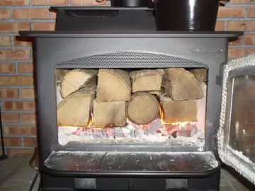

I load full in the morning and for the overnight burn, I load a partial load around 6ish most nights.
Here is an example of a pretty typical "full" load for me.

RDust-- Bro- It looks like you would have problems with ash and coals coming out the front when open the door. Do you? How big is your firebox, and how long do you get between reloads?

One of my cons(listed in the pro's/con's thread) on this stove is the depth below the door. I will sometimes get ash out after a load but never coals. Usually when I crack the door the rush of air will blow the ash into the stove and away from the opening. By the time I open the door all the coals are in the back half of the stove. It's a medium sized stove the firebox is 2.2 cubic feet according to the manufacture, it's 18x18x9 or 10 inches of usable height. During the week I load full around 7am, for the 10pm overnight and a partial load to get me from 6pm-10pm before I load for the overnight. Weekend is a little different since I'm around to feed the stove if I need.
