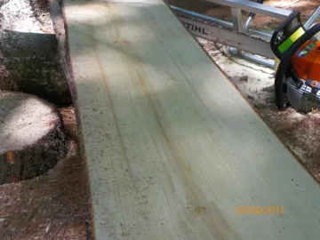

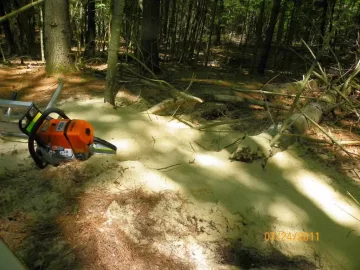

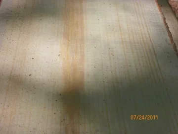

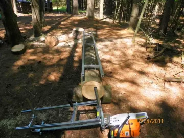

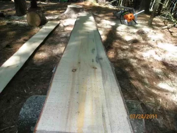

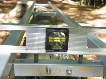

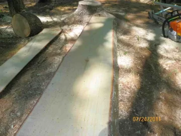

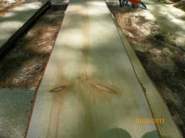

Finally dropped the pine and did some milling, we did a nine foot section then a seven foot section from the same tree. I decided to go 1.75 inches thick.
Left the aux. oiler off today but next time will put it on if we use the 36 inch bar. I would have gone with a smaller bar but only have ripping chains for the 36 inch.
Attached are some pictures that my wife took, she was the helper today and did a great job. The composite shims doubled up worked great.

Great stuff Zap. You're on the way now & there's no turning back! :coolgrin: Havent milled any pine,fir or spruce yet,but have a small amount of Eastern Red Cedar & an salvaged 80yr old Western Cedar telephone pole Qwest left for me - sure works fast & much easier than the various hardwoods I'm usually cutting.
Pretty darn good for your first run. Consistent perssure and don't swing the mill any even if you feel its stuck on something. Normally just a nut keep the same pressure on.
All and all thats a Awesome first run! :cheese:

I need to get the logs higher off the ground so looking for some ideas, have any?

Yea ramps and roll or winch it up onto a platform.

Nice!!!! Way to go.

Looks great Zap
I was surprised at how smooth the finish was I didn't realize a CSM cut that nice!

If your not getting nice boards your doing something wrong. So much going on thats easy enough to hack a piece up if your dont working it right.

Jay I freehanded a few boards but never tied it with a ripping chain just my full chisel.

If you cut that chain at 10 degrees it smooth right out. Stopping and starting and or wiggling the mill will cause line and give you a rougher surface. With just a little practice and knowing what the rough parts in your board says you can correct it and really start producing high quality cabinet boards.
