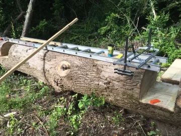

We are also going to need a rail system for our first cut. I have seen things from a straight 2x6, to a ladder, to making 2 brackets that hold square tubing. We are leaning towards the last idea there, but would like opinions.

My brother has had a Alaskan mill set up for 20 plus years. He has a Adirondack Shelter made entirely out of chainsaw milled wood and he did his barn beams. He also has a stack of thick live edged slabs. Its a very inefficient process with lot of safety exposure as the operators body is quite close to operating chainsaw and the engine exhaust. Cant do much about breathing two stroke exhaust fumes but I did buy him chainsaw chaps which subsequently had a few near misses.
The inefficiency comes down to a very wide kerf. It will be at least 1/4" wide and possible 3/8" wide. That means for every 3 or 4 boards you are putting one in the sawdust pile. Its really more than that as the resultant finish means another 1/8" minimum to plane up both sides.

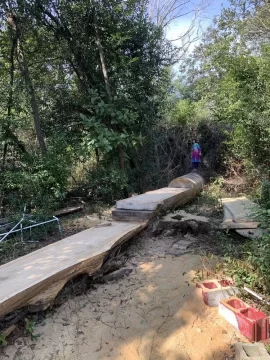

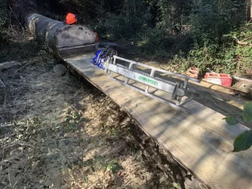

I’m $1200 in on Chinese 660 milling setup to mill up to 44” It’s been fun. Lots of work. Learned lots. Mostly slabs for fun things. tried lumber it’s hard. Nothing is true and straight. If I wanted to build I’d be looking for potable bandsaw mill. If I wanted wide slabs chainsaw mill. 900$ if it’s truly lightly used isn’t a great deal IMO. But given supply chains right now I’m sure someone will pay that. I am happy with my cheap Chinese saw could not have justified the cost if a pro level saw. $1500 buys a good bit of lumber. I could only get 2-3 slabs for that in the size I was milling.
