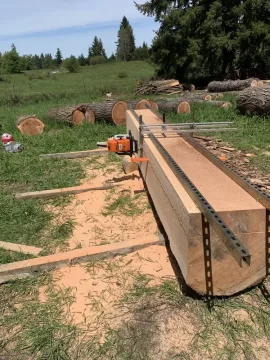

The biggest thing with any chainsaw mill is the chains/cutting . Spacebus and EbS-P can probably help you better than me as I use a chisel bit grinder that comes with its own challenges. Here’s my 6ft mill with an 880 making some cants for a buddy a while back. I’m really hoping I can incorporate my mill into my logging and tree removal. One would think it would be like peas and carrots but not the case. I hope you share some pics when you get going
Pretty cool setup. Thanks for posting. I'll get some pics along the way and post. Something is wonky with out Wi-Fi with uploading pictures. I usually have to take a ride down the road a couple of miles to get on a tower. Goofy.

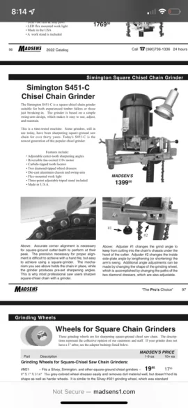

Doing any Serious milling you will want a grinder. Space had a thread or contributed to one where he decided on which one.
Yes, a grinder seems like a good idea. I like doing most things myself. Anything worth doing is worth doing poorly until you can learn to do it right. Lol.
I took it as far as buying a roll of chain, making my own loops and by hand, filing to a 10 degree ripping chain. By bars are 28”,36” and 52”. I could get 2-3 cut out of sharp chain. But I never got the grinder. Space is has his dialed in. But the tree is. Now gone and I don’t see any more milling in my future.
Tecomec Super Jolly. Best money I ever spent for a chainsaw accessory. Worth it if you are milling thousands of board feet, otherwise the bar mounted jigs work just fine.
Looked the Super Jolly up. Not an inexpensive unit but looks well made.
Reactions: SpaceBus and EbS-P
There are certainly more expensive and less expensive grinders out there, but this is probably the least you can spend for a semi-professional chain grinder.
Reactions: EbS-P
The next step up is expensive$$$$

That’s what I have. It’s really no where near the best chisel grinder and really the budget model but it works fine for me. There’s a learning curve chisel grinding though that I would say be cautious about. Helped being a timber faller for 20 years where I could play with the grind with chains that never saw dirt or rock and burned through 12 to 40k bd ft a day
