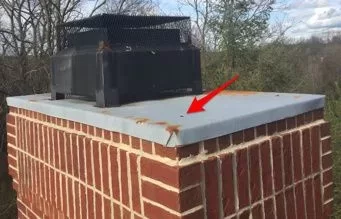

Short story: woodpecker made noise on top of chimney which is annoying, the real issue is that the chase cover move a little bit. I plan to go up and push it back to its original position. But is it more complicated than that? for example where is the screw to securely attach chase cover to brick?
Long story:
I heard this noise yesterday from the chimney flute :
When I got outside I saw the woodpecker on top of chimney. It flew away then come back a few minutes later. While it's annoying, my main concern is the discovery of Chimney Chase Cover dislocation, please see picture here, the gap caused by dislocation is marked as 1:
http://imgur.com/a/Kzt4E
We had high wind recently (in direction from 1 to 2) which might explain why the corner 1 of chase cover is lifted and pushed toward 2. So far there is no raindrop or water leak i can tell inside the house. I am thinking going up to the roof.

Step 1: push the Chimney Chase Cover toward to 1 and make it fit tight.
Step 2:
option a:
use "Lead Screw Anchor", something like this: http://www.homedepot.com/b/N-5yc1v/Ntk-All/Ntt-Lead+Screw+Anchor?Ntx=mode+matchall&NCNI-5 , drill a hole in brick, push anchor into brick, drill a hole in the metal, add crush washer, then drill screw into anchor. The screw in the anchor will make anchor expand and hold tightly inside the brick.
option b: someone mentioned using "clip on nuts" to pin the pan to the brick. But I am not exactly sure the feasibility
https://www.amazon.com/Clip-On-Nuts/b?ie=UTF8&node=6826021011&tag=hearthamazon-20
Step 3: Where I am up there, I may apply some sealant/filler to seal the seam, and spray ChimneySaver water repellent. I have no clear idea for this step, I am open to suggestion.
Is this action plan feasible? or I just over simplify it?
My question.
1) should there be any bolt to fasten the Chimney Chase Cover? I watch this video (), this guy use clue then screw on the side, but he attach it to wood, and mine is attached directly to the brick of masonry chimneys. From the picture I took (and also binocular from ground), i can't see any screw/bolt/nail on the 3" skirt (that fits over the chimney). And the screw/bolt/nail can't be on the top either considered it's main purpose is to avoid water. But is there any possibility that it just cover like this without any bolt to fasten it, and it's normal and acceptable?
btw, I found ths picture online, http://www.chimneysweepstn.com/uploads/2/0/4/5/20454447/1951559_orig.jpg. it seems like it have same setup as mine except it has two bolt drill in half way to hold the chase cover. I am guessing the bolt was drilled into the brick a little bit (or simply touch/pin the brick) to hold the pan. In that way, it's easy to take out the pan for future maintenance.
2) in the picture, label as 3, it face north, there is some stain on the brick. I am thinking it might be the chase cover metal starts to rust and when water runs off the top during a rain. i wonder should I sand it then paint it?
3) is this a diy work for home owner, or it's better to call a handyman or chimney masonry?
I rarely use the fireplace, I use it probably once per year during Christmas, it's merely for decoration purpose.

Hi Bob,
Thank you very much for your detailed suggestion. I wish I can see you post earlier. I just went up the roof, and pop the pan back to the chase. When it pop out again, I am going to use your method to fix it permanently.
I have 3 more questions if you allow me
1)Can I assume the drawback of GE silicone is future maintenance when you need to open the chase to sweep the chimney or other service?
You mentioned apply GE silicone on the top, can it be applied to the side?
is this the right one?
http://www.homedepot.com/p/GE-Silicone-Iron-Grip-10-1-oz-Clear-Silicone-Adhesive-HD90058/206692092
2) If go with tapcons, I need to use masonry drill bit to drill a pilot hole in the brick, then use this tapcon?
http://www.homedepot.com/p/Tapcon-1...Head-Concrete-Anchors-75-Pack-24330/100098197
3) I read the review at homedepot of tapcon, a fair amount of complaint is that tapcon has no holding power. Is it usually a human error or it's a common issue related to this type of fasten mechanism (into the brick)? any tip you can offer to do it right?
Once again, thank you very much!

I went up there and take a look. I move the metal pan a little bit so it fit the brick of masonry chimneys. The problem is next time high wind will move it again, so I need to find some permanent solution.
Sorry about the photo quality. there are 4 nail (or screw) on the top. and I am thinking underneath the metal pan is the wood frame. The easiest thing to do is to add another nail/screw/tapcon on the adjacent spot (maybe seal around the nail head to be safe) . But if I understand correctly, I suppose to use nail/screw/tapcon on the side (instead of on the top)? What's the best approach here?

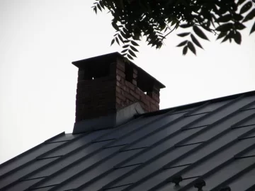

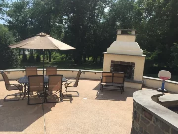

Crude. Put a proper topper on it! I have the same type of flagstone topper on three of my chimneys, and they work very nicely.

Crude. Put a proper topper on it! I have four, three of them set up with a flagstone topper:
I cant stand flagstone ontop like that yes it holds up well and looks good but it makes working on the top of the chimney a real pita. But I agree he needs a stainless top plate
My chimney guy doesn't mind it, but mine are set up pretty well. The small patio fireplace doesn't get swept, but the two taller ones on the house are both very easily removable. One is only 18" square, and the larger one is in two pieces with the flue centered under one piece. He simply slides that piece on top of the other, sweeps, and slides it back.

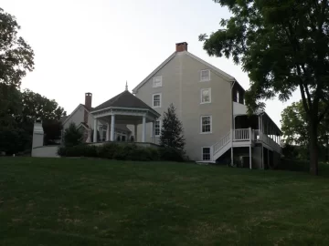

wow, very nice house.
is your roof steel?
Thanks. The roof on the part of the house you can see in that photo (which is the 1770's wing) is standing-seam metal installed before my time, so I can't be 100% certain of the material but I do believe it is steel. That's the back corner of the current house, which I believe is built upon the corner of a former house on this site, dating to 1738. Subsequent owners have been expanding it ever since.
