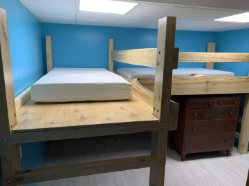

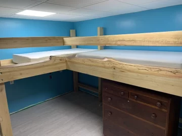

And here I built this entire thing with only thing square or true was the two parallel faces the planer left me. Everything was just marked and cut to fit. +\- 1/32”. It all shrank more than that when I brought it inside;)
Good job on the loft.

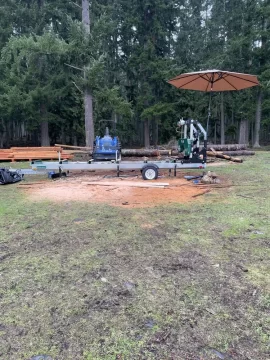

I took a picture of my new umbrella to show the wife the other day. I’m in the process of moving a huge stack of live edge out of the garage without the tractor and even after a couple years these things are back breakers
Looks like an awesome setup.
Reactions: Nealm66
