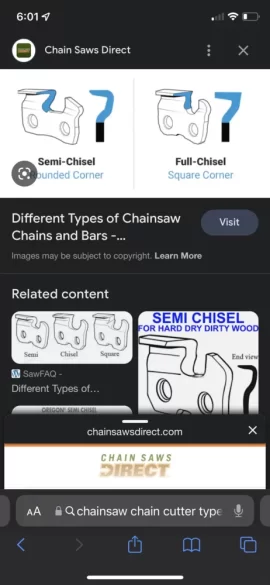

What differences are you referring too
From MadsensDoes the semi chisel cut better than the traditional round chain as a rule? Maybe not last as long in dirty type woods but better than full chisel? I know with full chisel, one good rock can ruin a practically new chain for production use. Also, can the semi chisel be chisel ground/filed?
I have a handful of semi-chisel for 20" bars that I received with a used 063 PRO, and they seem to cut only slightly slower than full chisel, for typical bucking in oak and ash. They're supposed t stay sharp longer, which may be true, I've personally not tracked that.Does the semi chisel cut better than the traditional round chain as a rule? Maybe not last as long in dirty type woods but better than full chisel? I know with full chisel, one good rock can ruin a practically new chain for production use. Also, can the semi chisel be chisel ground/filed?
Semi chisel and round are the same thing.I didn’t see the semi chisel in the madsens link but it’s ok. I can probably find some more info on it or just ask down there at madsens. They have new owners now. Really miss having a donut and coffee once in a while with old Ralph and the old guy that used to do there mods. They’d be in there almost every morning after Ralph retired and his kids were running the show
I've gone as far as 5 degrees, but find 10 to be the best blend of speed and cut quality. My ripping chain is round/semi chisel with a round grind. I've tried full chisel, but it goes dull way too fast, especially with logs that I've dragged through the clay/grass/dirt. I've considered getting a three angle file and using a jig to put a square grind on one of my full chisel loops, but I'm not sure there's really any time savings for me, especially sawing 90% softwoods. My Husky 460 with the rakers set way too low and a nice grind just flies through wood, and I can clean up six chains on my grinder in less than an hour. I get that my time is valuable, but by the time I've bought and figured out how to use a square grinder, I could have cut a lot of wood and sharpened a lot of round ground chain. I'm also not a professional faller and I'm not feeding my household with a chainsaw either.Weird. Maybe why I hadn’t heard of it. My neighbors were round filing chisel chain when they borrowed my 4’ mill and milled quite a bit up actually. They sent some loops out and had them ground to 10 degrees and if I remember correctly, said it improves it a little bit but not crazy amount. They weren’t sure if the guy that sharpened had much experience grinding to 10 though. My chains cut pretty good ripping. I messed with the angles till I had a happy medium for normal use as well although I’m not under the production pressure I used to be
