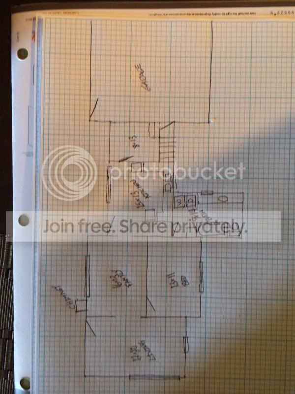

Can anyone recommend a location for the stove? And I want to make sure I get the right size too. I'm not heating the upstairs, or basement, I just don't want pipes to freeze. It's happened under the bathroom before. Not worried too much about the bedroom or the 8x13 porch either, mainly living, family, and kitchen I guess. Thanks for all the help. I think right now I'm leaning towards the quadrafire classic bay, or the 6yr old Harmon XXV. Quadrafire is 3,000 with pipe, Harmon is 1800 with pipe. What's you guys thoughts between these?
[Hearth.com] 6yr old Harmon XXV price
not enough info here for a recommendation....clearances, furniture, stuff outside, etc....download a manual?
I'm not worried about clearances, I'm thinking where at in the house. I can get you more info. But really anywhere there's not a window or door would be fine with furniture and anything outside. Except the chimney which I drew in the pic
