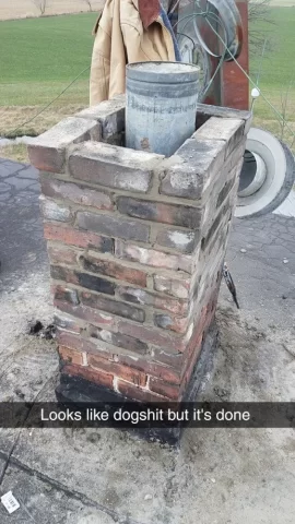

I have a 7" galvanized liner in my chimney. It is 34' 4" long and roughly +40 years old. I need to install a 6" insulated sst liner to be able to use my wood furnace.
My question is do I install a 6" insulated liner down the center of the 7-inch liner or should I remove the 7" liner?
  • [Hearth.com] 7" galvanized liner in chimney. Remove or keep it?
It'll have to be pulled out. A 6" insulated liner won't fit. It will be about 7.5-8" OD, so there still may not be enough room. You might need to look at pre-insulated 6" liner with a smaller OD. DuraLiner rigid is 6 5/8" OD.

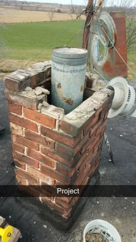

Is the chimney top getting rebuilt too?
Yeah, I'm gonna repoint with new mortor. I didn't think it was that bad till I took the metal cap off.
How do I remove 34' of 7" pipe? It's in sections, but I don't know how to disconnect it.
The top looks like it need more than just pointing, it looks like it needs to be rebuilt.

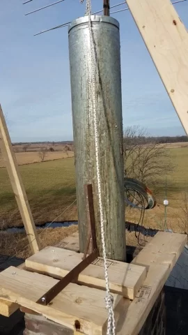

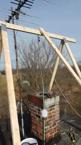

I removed the liner. I made a 8' tall saw horse, pully, rope and come-along setup.
The 1st section i screwed to the angle bracket and the bottom section fell off inside the chimney. So then i had to fabricate a scissor clamp to grab the that liner. I got it to work, but after that section was out and screwed the bottom section came off of that! So... i came up with the idea to rap the rope around the bottom tee and pull it up. It was lite enough to pull up by hand.
