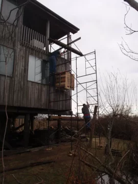

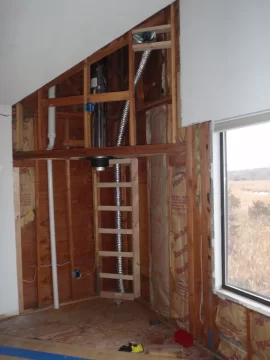

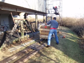

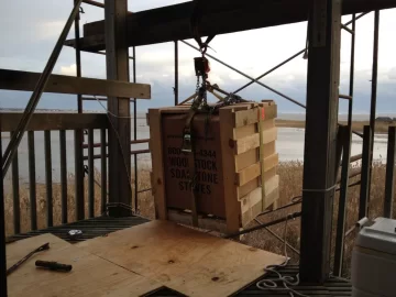

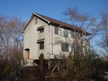

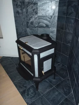

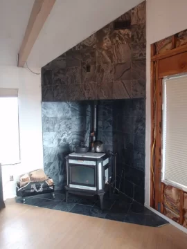

Thanks for all the help here guys! Got some great info on this site! My new stove is peacefully resting in it's new home, after what I'm sure the stove thought was an "interesting" day! By interesting of course, I mean SCARY! ;)

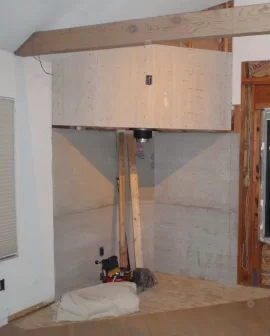

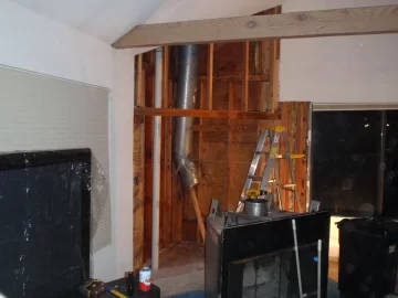

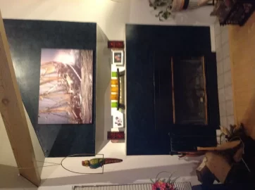

Ripped out the old Heatalator insert fireplace, removed 1/2 of the wall, re-framed it, moved a bathroom vent pipe from below and buried it in the wall, moved the OAK duct and left flush ion the floor for easy hookup and use later if needed, ran new duct from above the stove to the bedroom on the 1st floor below with an inline blower. Ripped out old and installed brand new tripple wall SS chimney. Durarocked, tiled with Silver slate, and finally, hoisted up a Woodstock Progress Hybrid 3 flights via scaffolding and onto a deck, and hand trucked onto the hearth.

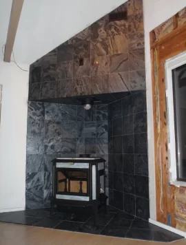

DONE! The stove is a work of art! She's all together and ready to go, just waiting for an adjustable pipe to make it meet the chimney nicely. Will fire it up in the morning.
Before, during, and after pics including the hoist!

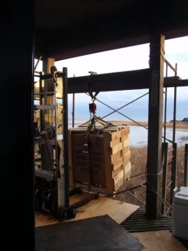

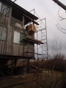

[Hearth.com] 750lbs 3 stories, no problem!   Progress Hyrbrid install pics[Hearth.com] 750lbs 3 stories, no problem!   Progress Hyrbrid install pics[Hearth.com] 750lbs 3 stories, no problem!   Progress Hyrbrid install pics

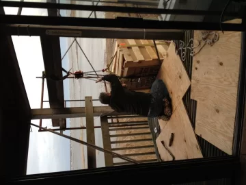

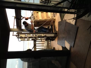

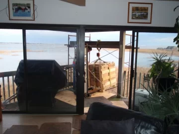

A few more pics of the hoist.... hard to tell from the pics, but at the top, the stove is hanging 35' above the ground, was pretty scary pulling it off the hoist and onto the hand truck.

Wow talk about a scary install! Excellent views there I can see why you like to be there! The hearth looks really nice along with the stove.. How many square feet are on the floor where the stove resides? My concern would be too much heat on that floor and no heat on the other floors..

So.. I am thinking.. awfully close to the combustible floor in front.. LOL... no door there. Looks great.
I am interested to hear how the powered vent does to move the heat from upstairs to downstairs. I am guessing that is the vent at the very top of the new tile work? Moving air around is always an interesting topic..

Love the scaffolding idea. Also, how they leveled the scaffolding down below in the mud with those lumber scraps.

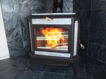

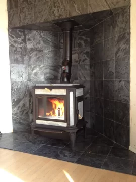

Thanks for the compliments, as most of you know probably know, it's MUCH nicer in person! Especially when you can feel the heat. ;) Got a little seasoning fire going now. Installed the adjustable elbows this morning, and fired it up with one match (lit the corner of 1/2 a super cedar, more great advice from here!). I put in 2 small splits, one in front and one in back, the super cedar in the middle and piled up some kindling across the two splits over the cedar. Lit it, 15 minutes later the pipe was about 275 so I closed the bypass. That was at 8:45 this morning, and it is still going strong. Stove top is 210 in back, 195 in front, lots of hot coals still burning. 3 hours on two little splits??? WOW! I would have made 3 trips down the 3 flights by now to feed my old fireplace, and the rest of the hosue would be freezing because it sucked all the heat out. Love this thing already.

She's up and running, you didn't think I was going to sit here and stare at it for too long did ya? ;) Will of course update after I get some real fires and experience with it though. So far, nothing not to LOVE.
It is 25' by 45' (1125) open room. However, cathedral ceiling in the entire room, with a loft on each end with a spiral stair and a catwalk between them. Then add in that their are huge 69"x60" windows all the way around 3 sides of it, and two 8' side by side sliding glass doors next to each other going out to a deck (the one the stove was brought up on). The windows and doors were ok, but I had replaced the glass on them about 5 years ago (they were leaking and getting foggy) and they never got them sealed perfectly, so they are not very drafty. Now throw in I'm on the water, with 2000 acres of wetlands behind me with no tree's, just open air to the bay and ocean, aka we get blasted with cold ocean winds. Right now it is blowing 35mph, with stronger gusts, I bet the other end of my Rd, away from the water it's blowing 5 to 10. It's amazing how much different it is on the water with nothing to block you from mother nature. Those winds are going right thru my windows right now, you can hear and feel them. The downstains of house is same size, but broken up into 3 bedrooms, an office, 2 full baths.... so nowhere for a stove.
I am 12 1/2" from the rear corners of stove to the wall. The clearance is 12", so I have a 1/2" to spare. I am 9" from the front of the stove to the front of the hearth (end of the slate tile). The clearance is 8" with the Ash Lip, so I have an extra 1". Oh, and although the slate appears to be laid right on the oak flooring, it's not. The oak floor is only covered with slate for 1/4", beyond that there is 1" plywood and 1/2" Durarock next gen under the 1/2" slate. She's all good, and all to code. Chimney is 13' of tripple wall class A stainless in an inside chase, the last 2' are otuside above roof. And about 38" of stove pipe to the stove.
Yes, the black vent at the top right corner (highest point) is the intake, I ran 4" flex duct, and insulated it down behind the stove (you can see it in the pics) and down into the joicing below floor. It then travels about 10 or 12' between the joicing and pops out the ceiling in the master bedroom below. Directly below the stove is a bathroom, and in the ceiling I cut a 10"x10" cutout, and installed a 185cf inlive 4" fan. I ran power to it from a simple speed controller mounted on the wall in the master bedroom. So we can control how much air we want based on the temps... I'll see how much this works, I think it will be enough to heat our bedroom most of the time, and even supliment/spill over to the rest of the 1st floof. It can't be any worst than it was with the fireplace, that is for sure.

Don't laugh! That is kinda the plan. I'm planning to install an electric lift off the top of the deck. Just a simple winch similar to the ones you would use on the front of a work truck. I'll hang it above the ceiling of the deck a few feet off the house, and drop it down, load up some wood and pull it up and unload to stove a few feet away. Thats the next project. ;)

Since so many mentioned the view, here's a few shots of the view in different seasons, and the first seasoning fire this monring. Enjoy!
