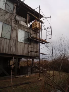

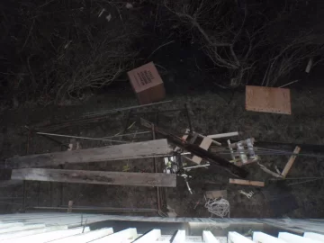

That's pretty impressive all around! I'm sure the folks at Woodstock would like to see those pictures. Good to hear that the stilts saved you. Did you or the installer do the rigging? Must have been slow going. What was the lift of your hoist? How many times did you have to set the stove down and re rig?
But I didn't have the heart to do it. Could of been pretty funny though.![[Hearth.com] 750lbs 3 stories, no problem! Progress Hyrbrid install pics [Hearth.com] 750lbs 3 stories, no problem! Progress Hyrbrid install pics](https://www.hearth.com/talk/data/attachments/85/85971-290f4d29c95506d7f91440d0937d4b57.jpg?hash=CNvHflarkF)

Gotta say your installer is top notch with great rigging skills! I would expect to pay a large fee for such an installation. This has to be the most challenging installation I have ever seen..
