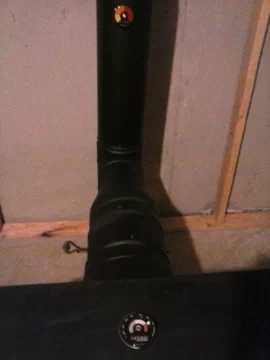

The chimney does get hot to the touch. Right now when it is running at around 300 or so, it is hot but I can put my hand on it. When I ran the stove up to 650, the flue was obviously much hotter (probably 450 or so) and was too hot to touch and would burn a hand. I think insulating the chase walls won't therefore be necessary and may even cause excessive internal heat. I was worried about the wall bands getting too hot as well but they aren't really transferring any significant heat back to the wall studs, which is great.

The thermometers I got are also useful - I can glance from across the room at the colors and make adjustments.

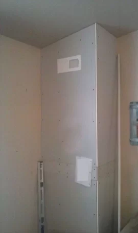

Put a 4" x 10" grille at the top and bottom of the chase to ventilate out the heat and add a little room heat too. A damper on the stove pipe is a common remedy on old stoves. It will slow down the flue gases a bit, keeping the flue a bit cooler and the stove a bit hotter. Don't forget to open the damper before opening the stove doors or you may get a snoot full of smoke.

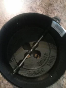

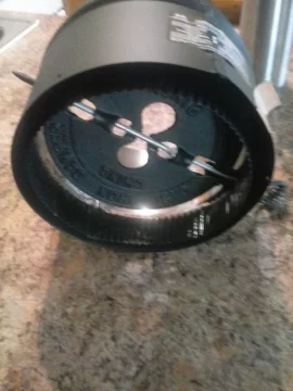

With double wall pipe and inside chimney you probably have way too much draft. Yes, a damper is needed. Close it to keep the flue temp down when burning harder. Or better yet, Baffle it too. With 8 feet or so of single wall pipe it cools enough not to need the damper as much. In your case what comes out of the stove is waste and you want to control that.
When you start it and hear a roar up the stack, close damper until sound stops. That's a good indication where it should be set. With baffle you can run it with damper farther open.

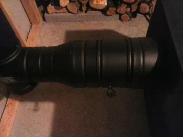

I originally planned to use a damper for safety and it has been on order since before the holidays but I believe it will finally arrive next week. I should be able to fit it in between the stove adapter and reducer. Doing so will nicely bump the stove clearance to 36 inches from the back wall as planned.
I thought the reducer and 90 degree tee would impede flow enough to not need a damper but as coaly says, I think the draft is strong. I think this points to a good, safe installation and I'd much rather start with too much draft than too little.

When you start it with kindling, you close the damper to slow it down leaving draft caps open a couple turns. This keeps more heat in the stove to get the larger pieces started. Closing the air slows it down, but when starting that is not the time to deprive it of air. Just close damper slowly until the roar stops and it will come up to temp. As it gets hotter, close down to a turn or so.
The colder outside, the farther closed you will run it, since the colder it is outside, the larger the temp differential and the stronger the draft.
The damper doesn't change pipe temperature by holding heat back, it slows velocity in pipe and affects the stove by slowing air coming in.

A look at the Selkirk 8 inch damper:

Here is a look at the damper and reducer installed:

A look at the chase enclosure:

Does the enclosure have an air vent at the bottom for cool air to enter? Does the outside of chimney pipe stay cooler now?
I have the other matching vent, just haven't cut it in yet. I will install a magnetic thermometer on the pipe just behind a vent but am not sure how hot it gets in there lately...
