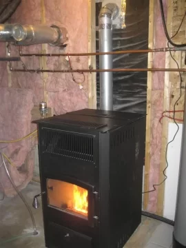

So far so good with 1/3 bag, the fire at 2 generate a very good heat, specially
in the furnace room (90F).
The glass seems to be willing to stay clean, the cycle/procedure of the stove
had me confused a bit when not used to it, Shut it down after a quick run last night
and started it back this AM without my intervention :) and did well.
Here's hopefully a picture (first time posting one)...
  • [Hearth.com] Drolet ECO-65 exhausting in OFF Mode
