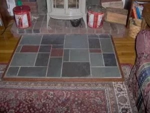

And today I got a 30" x 48" hearth pad for FREE on craigslist!!! The 35 minute drive from my house was totally worth it. It's a nice grey, blue and red slate covered fireboard with wood trim on three sides. If you keep looking there are some really good finds on craigslist!

Here's a pic of the heathpad, this was from the craigslist ad, and it looks kind of dingy here - looks much better in real life. As for the Jotul, I should have taken a pic before removing or taken the pic from the ad (which has since been removed), but it's now in pieces with the surround removed, doors off, etc, so you'll have to wait until the install!

Nice looking hearthpad that will go with most anything Ken!
Ray
Ray
Yes indeed, considering the price.
