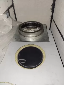

I've got a new construction build with a ZC Osburn Stratford II that I am installing. Wondering if it is a common practice to run a bead of fire caulking when attaching the anchor plate (Duratech Duravent) to the top of the fireplace?
[Hearth.com] A couple of quick questions - DIY Install [Hearth.com] A couple of quick questions - DIY Install
I've got a new construction build with a ZC Osburn Stratford II that I am installing. Wondering if it is a common practice to run a bead of fire caulking View attachment 315913View attachment 315914when attaching the anchor plate (Duratech Duravent) to the top of the fireplace?
Nope not unless the manual tells you to. Just follow the directions exactly and you will be fine
Reactions: webby3650
We install a lot of Kozy fireplaces. They send a tube of furnace cement for the anchor plate. It can’t hurt.
Yes furnace cement can't. Silicone could possibly overheat and smell horrible
When I installed my Stratford II the tech department told me to go ahead and use high temp (2000 degree).
