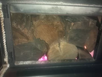

That is really all there is to it. Once the load is charred and starting to offgas well, you can start shutting it down. How long that takes depends on your draft and fuel. I have never spent more than thirty minutes at it, unless I have really packed it in there and not had much airflow between splits. Those loads take a long time to get rolling, but they burn for a looong time ;).
