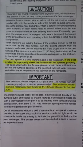

Your ductwork is absolutely your problem. I will send a pic of the installation requirements of a 60,000 btu unit in just a moment.

Here it is.
@mike van , I am pretty sure this means your ducts are too small. You can insulate small ducts and still have your current problems. You can install bigger/more ducts, and solve the problem potentially without insulating them.
At least that's my bet based on your post.
What size is the main trunk ? I assume the 2 x 12 is the register opening in the floor ?
