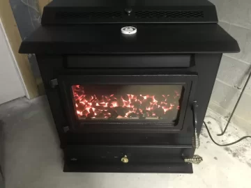

I know coal burning has had virtually no representation here. I’ve decided to give it a try. I’ve ended up with some pretty severe back problems, and will be needing surgery soon. Processing wood has become a thing of the past for me much too soon. I decided to pick up a Hitzer 50-93 hopper stove. So far so good!

Hitzler makes good stoves. What chimney are you running it through?

Cool! Curious why coal over pellets?
Been there done that! Never again. Sourcing pellets, comparatively low btus, and very high maintenance. Other than the blower there’s no moving parts that require electricity.

On the coal stove, how heavy are the loads to fill the stove and how frequent? Do you have access to anthracite coal?

The bags are 40lbs. I’ve got two young teens and strong wife, they can handle the bags, but not the processing of firewood. We are about 20 miles from a very large Amish community that sells lots of anthracite coal.
It’s 304 inside and out.
As soon as you are done burning clean it and spray everything down with wd40. That will extend the life a little but coal will still eat 304 pretty quick

Why do they call it “all fuel”? Thanks for the heads up. I’ve seen you give this advice before to others. I appreciate it.
No clue why. Oil and gas will do a number on 304 pretty quick as well. It is really only good for wood.

Thanks, I appreciate that. I’ll keep a close eye on the flue too. It’s exterior, it runs through a block wall and up beside a stone wall. I feel it’s as safe as possible considering.
It isn't a safety issue at all. Atleast not untill the coal eats through the liner.
I understand the risk. My point is that’s it’s outside, so the CO risk might be less likely to be an issue. If the flue doesn’t hold up, I’ll put a new one in the same day, no problem..

I might even lay up a masonry flue if need be.

It's nice to sit in front of a wood stove. How does a coal stove compare? I imagine there's less to look at, but more heat.
The day I have to buy wood I'm switching to coal. With the right size stove and coal size coal will out perform wood almost always and you can't beat the steady heat output IMO. You will enjoy that stove.
