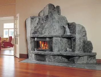

A Tulikivi Brought Back from the Dead
It sounds like fate dropped this sopastone heater into the right hands. You did a great rescue. I hope you have a lifetime of warmth from that beauty. Please keep us posted on it's operation, cleaning and heating as you get used to running it.

IThe gentleman who I got it from was a family friend and used to install these. He used this particular heater as a display for home shows. I was able to get it from his wife after he passed.

So far what I have learned from the heater after a week of burning:
-It drafts incredibly strong with only 12.5' of chimney above. I may have to add chimney as temperatures warm up, we'll just have to wait and see how that goes.
-Unfortunately all of my firewood was cut and split with an open hearth in mind so they are larger splits. Many around 24" and up to 8"+ diameter. Forcing me to load the splits standing up vertically and limiting how full i can fill the firebox.
-I am still determining where I would like to place the rough cut stones (shown on the right of the heater in the finished picture). I will update with pictures when I have those set and finished when I get around to it, I am having too much fun just burning it for now to put any more work in.
-I am getting firebox temps over 600. Stone temperatures between 270 and 180 after 3 to 4 hours of burning.
- Burn times are short, as expected by design. I'm getting around 1.5 - 2 hours before I throw a few more splits in.
-For the most part I have been burning with the air wide open. This weekend I will try playing with the air control more when I have time to keep an eye on how the fire reacts.
Thank you all for the responses and input. Great to see!
