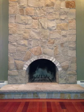

[Hearth.com] Accentra 52i insert or Freestanding P61 Here is where the new stove will be going.
View attachment 124785 Here is where the new stove will be going.
The insert and it's surround are square vs arched. Measure carefully that opening or have a dealer take a look and do the measuring for you. Have the dealer explain the various options to you. It may be kind of either an odd fit or odd looking fit. I could see the fireplace opening blocked and a stove in front, if the insert doesn't work out.
Is there room on that hearth for a stove ? It looks as though an XXV might fit there but the P 61 and P68 are longer from the fireplace face to the edge of the hearth in comparison. They also sit fairly tall. So measure that carefully as well.
You're heating 2500sq ft, is that what I read ? You might find at times that maxes out the P52i or XXV. The P61 would have reserve. Of course so much depends on layout and insulation factors and also some fans out and about to help deliver air.
How about corner placing a stove in that room? Installation will likely be much cheaper, there won't be hearth depth issues, and best of all, you'll retain the use of that beautiful fireplace. You could make a hearth pad out of similar materials, in the same style, and have it look pretty slick, IMO.
You have a very good eye. I have already measured the opening a million times and I would have to take one brick out on each side of the arch for the insert. There is plenty of room for the width and depth and the height of the stove would completely cover the arch. The XXV is 26 1/2" deep so that wouldn't work either on the hearth because it is only 21". If I was to extend the hearth and go with the P61 or P68 they are
both 23 1/2" wide and my openeing on the fireplace is 34" wide so that would leave 5 1/4" on both sides which isn't all that much. What do you suggest blocking the fireplace openening with or would it look all that bad with the 5 1/4" on both sides.
No that's all about your own preference if to block or not or what clearances you will like.. Most people do not close it off due to cleanout access.. I have to say that the arch is lovely, I wouldn't want to take any bricks out of it if it were mine. Not sure I'd want an insert in there covering the arch either. Our fireplace is crude, I've had a plate in front of it for more than 30 years with my coal stove on the hearth. But we may be opening it up when the P61 goes in just for the sake of ready access to the vent piping . With coal we have rarely had to clean beyond the damper flapper in the vent collar, Most ash that escapes the stove collects right there. Just dump a pan heaping full of ashes every single day, sometimes twice... About 4- 5 bags of coal once burned, equals nearly a full bag of ash. Compared with 1 to 1-1/2 ton of pellets to collect a pan full but there is no burner blower running other ash through the stoves system or venting.
What do you think of that corner install idea another poster suggested ? I considered this in my house, it was a no go with the wife ( she lives here too) and for me actually that also would give the best blower direction to heat the down stairs of the house, which is something you might want to analyze in your layout.
The corner install or for that matter no other place on the first floor would really work. I have looked into that already but there are windows everywhere or something else. Where the fireplace is
that's my best and really only option. The good news is that it's pointing directly into the 5' wide cased opening going into the kitchen where you enter the family room from.
