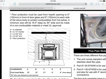

I would also ask ur dealer about clearances to combustibles not sure that set up will work if that is a wood finish ur accentra will b setting against
I found this in the installation manual

I believe that the zero clearance box takes care of what's behind the stove but in front of the stove and sides I'm sure u have to go with the measurements I sent take all this info to ur dealer and get his opinion show him a pic of ur fireplace and explain everything u want to do so u have a good idea what needs to b done.also those measurements in the pic I sent u if u measure from the points they have there every measurement in the pic extends past ur standard cast surround for non combustibles

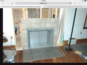

Here's a pic of a zero clearance box installed for an accentra. Doesn't appear to have anything to do with clearance to combustibles on the front side of the stove

Well that's interesting. That pic almost looks photoshopped to me because outside of the box is opaque over the face of the tile surround. Almost like there is some type of film over the surround. I'm sure it's not, but it does look curious. This is interesting though. So that ZC box bumps right up against that tile surround. I'm assuming that is not a combustible surface?
