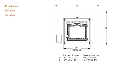

Most of those gas inserts are notoriously inadequate and it's questionable as to how many brands or models actually put out their rated btu. A pellet insert will put out some serious heat. I would think something like the P35i from Harman would do well in your house. It will fit in many fireplace spaces. You may need a o clearance liner in the existing space. But clearances can be pretty tight with them at any rate. You can also go free standing stove and more or less direct vent, though with most installs the vent flows better with some rise. We have shop owners and installers at this forum, maybe one will show up ! Your house doesn't look like a nightmare situation to heat with a stove though, be that insert or free standing.
There are other brands and models, I just suggested that one because I know it fits about any fireplace, prefab, fake fab or real brick and mortar. There are people here with more sq ft than you heating with the same insert, FWIW.
Thanks- so the P35 looks like a direct fit. Looks like even the Accentra 52i would fit in as well, although that unit comes out onto the hearth a bit far. I'd be worried that thing would burn us out of the room. Does anyone know if the thermostat on the P-35i is wireless?
