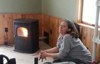

Do you have it installed and running? Pics or it didn't happen! We like pictures here. Congrats and Enjoy the heat!

Nice! Answered those questions. Nice stove! You'll love it. keep us posted and stay warm.

Looks goooood! Enjoy it. I love my Accentra and I am sure you will love yours.
P.S.: Only real difference I have seen to running it on low for extended periods is dirty glass sooner. No big deal at all.
Get that stove hooked up to a surge protector! I see some small box but not sure if it's a protector. Look in your manual also for a UPS Uninterruptible Power Supply compatible with your stove model since you have a thru the wall horizontal vent too. They cost a little bit but worth the money. I paid $100 buck for mine but bought it locally in stock. I saw where others have found them online for $60 to $80.
They offer better surge protection and also have a battery back up for a proper stove shut down in the event of losing power. This get the smoke out and then you don't get any into the house, etc;
