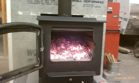

I open the draft full, put a small split on top and try to burn them down. Recently I've been burning more douglas fir and the coals aren't too bad when draft settings are high. Here is a pic of bigleaf maple from last year. I blow on the stove with a box fan, OEM blower on high, and keep STT under 650. It's been a great stove.

Hmm, at that stage I would still get secondary flames and the stove would be above 500 F. Maybe I would open the primary a tad from being fully closed but that would be my only adjustment.
