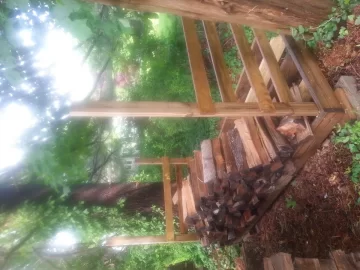

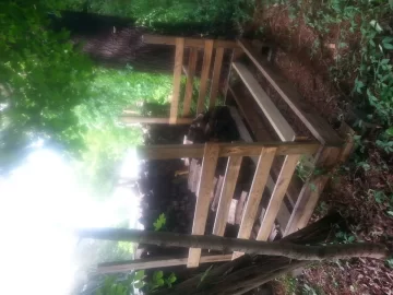

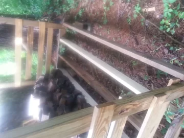

Okay, I need to add a roof on this 5 x 8 wood crib for seasoned storage. It has 2x6 pt joists, but only 2x4 posts. I was thinking of sistering another 2x4 to the posts, and putting in an OSB floor. I'm planning a pretty radical slope, both to catch wind and shed snow. It has a lot of taller trees over it so not alot of snow will accumulate.
Should I approach the roof as a house roof?

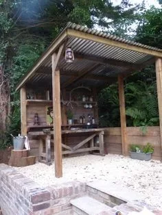

Like below, except that's square and you won't need that brace unless you go crazy with an overhang.

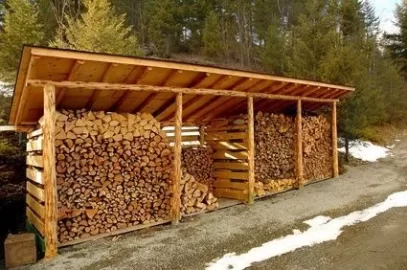

[Hearth.com] Adding a roof
you'll just have one section instead of the four shown and you won't need the plywood unless you want to and you won't have that many rafters.
That one looks like it is made of all round wood and may be fastened together with those long lag screws that are almost the diameter of drywall screws. Can't think f the name of 'em off-hand. Round wood, dimensional lumber, they're all sticks.

Just slap a header the length and pitch you want on each side (side being the two short dimensions, your 4 feet deep ) ( use your carriage bolts :) ) then nail the three stringers (8 footers or 93-1/2 inches whatever fits ) between them.

billb3, The second shed is a beauty but a lot of work peeling those logs.
I know you were just using as an example for framing out roof:)
