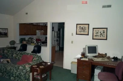

    I was explaining to a coworker about how my woodstove heat tends to stay in my den with the vaulted ceiling. He suggested I cut a vent higher up on the peaked part of the wall to let captured heat flow into the upstairs. Attached is a diagram. I drew a red vent up on the wall where this could be done. A spare bedroom is on the other side of that wall. The vent would be on the lower part of this bedroom wall. I would try to use vents that look like the existing ones used by my heatpump ductwork. He said this would aid in establishing a convection flow where cold air would flow into my very warm den as warmed air flowed through the vent into the upstairs.
    I'm not trying to tie this in with my ductwork. This would be a pass-thru. And I do already have a ceiling fan in this room as well as a small box fan forcing cool air into this room (so that it spills out the top of the doorway and the kitchen opening). I could just use more help distributing the heat.
    Craziness?

    Hot air will never be able to penetrate into that vent. The colder surface air at lower levels, will win every time. Supply without return is useless
    Return without supply again useless.

    My picture at the start of this thread shows 2 original HVAC vents on this wall. They are connected via ductwork to all the bedrooms of my house. I am not aware of any smoke dampers inside this ductwork. Should I seal off these vents to keep a fire from spreading to all my other rooms?
    I agree with Sandor that I will not achieve much airflow without some kind of fan assist, and I don't feel like fooling with that. I thought the rising heat would help flow through that vent. There is a set of stairs leading downstairs right next to that room.
