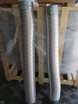

See in the picture the flex pipe which I've got. So, if I don't insulate this pipe with something I see the temp inside the chase raising up. But with what kind of insulation.

Is this 6" round flex? This will work, use metal tape to seal.

I don't think this will work. Checking the spec of this insulation I see has the flame spread rating less then 25, which is the same as gypsum sheathing. As no drywall is accepted in proximity of the fireplace I don\t think this will be accepted as well. Maybe I'm wrong but this is my interpretation here.
Not sure flame spread rating is applicable here. This is what is typically used on warm air ducts. However, you could get 15' of chimney liner insulation and use that instead.
