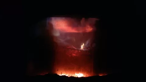

Several weeks of haze, and that's about it. [Hearth.com] Advice from the more experienced on sooty glass

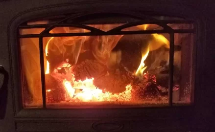

About as expected. Cats run a bit dirty on the window. Our glass hasn't been cleaned yet this year and there's no soot on it. This is after burning about 3/4s a cord of wood. There is starting to be some ash build up. I'll clean it this weekend.
Kinda gross. Our glass hasn't been cleaned yet this year and there's no soot on it.
That's not soot, it's just dark so you can't see the glass on the sides. If you look in the lower left corner you'll see that it's clear, except for the same haze you see in the middle.
See above. Posted a shot of our stove for comparison. I'll take a non-cat for fireview.
Hard to tell from these pics but that looks like some light haze from here, not as bad as mine though. But if you say it's clear, it's clear. Then there's the other factors like the different woods we're burning and the fact that your stove is running hotter, longer into the burn. By the time it cools down, a lot of the gunk is burned out of the wood. That pic I posted was right after I lit off a load of Cherry and cut the air, but still a lot of flame. Flame was out shortly after that. I'd certainly agree that non-cats are gonna stay cleaner. I just took issue with the earlier statements that cats are known for gunky glass. BKs, sure.. ;)
