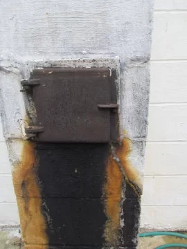

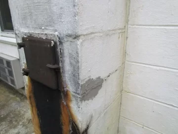

The cleaning door for our chimney is falling apart. Before we replace it, we want to track down the source of the creosote that sometimes dribbles out of the door. The door sits about four feet below where the stove's exhast pipe connects to the chimney. We clean the chimney regularly, at least three times each burning season, and from quick inspections with a mirror, we get very little creosote above the exhaust pipe. Could this be just cold air being drawn into the chimney around the broken door? And should we be concerned about the cracks in the mortar at the level of the chimney door? If we need professional repairs to the chimney, we want some knowledge about what our chimney truly needs. Any advice would be great.

I would suggest having the chimney inspected by a pro. Just looking up with a mirror it is very hard to tell how much build up is there and what condition the liners are in. But by looking at the creosote stain there i would bet that your chimney is glazed up pretty badly.
Not to be smart but the source of the creosote is the chimney. It is condensating and running down the interior of the chimney and out the door. I suspect there are several things that you could do to remedy but it is all going to depend on the set up that you have, such as, where is the stove/fireplace located in relationship to the clean out? Is there an area that is depressed just inside that clean out door where a shovel full of sand can go? Tough when we can't see everything....Not your fault of course, just saying.
Of course the source of the creosote is the chimney.;lolWhen it's running out of the clean out door it's a sign of excessive build up. It's also likely there is no cap. The water mixed with creosote will really expedite the corrosion of the clean out door.

You'll care much less about that door, with an insulated stainless liner slid into that chimney. [emoji12]
