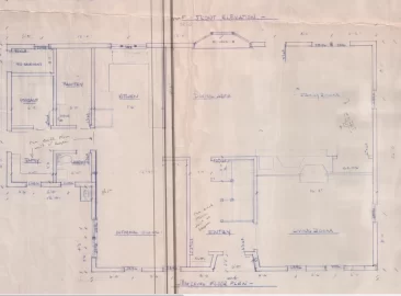

I recently installed a new hearthstone mansfield in the kitchen area where it says "stove" in the drawing. This does a great job with the downstairs, kitchen, and family room but has a hard time getting into the stairwell or living room beyond the wall.
The upstairs however, is not getting much heat from this stove. In the drawing below is a smaller room "living room" that has a good size wood fireplace and a 8-10" liner installed from a prior chimney fire from the adjacent flue. We use this room to watch moves, work from home at a desk, etc. The door opens directly into the hallway with the staircase to the upstairs.
Would a wood insert in this space overwhelm the room with heat? The hallway in this area gets cold as the upstairs is all baseboard electric and we try to limit the use of that.

It would have to move through this 36" wide doorway into the hallway which is all open with an open staircase.
36” doorway means the room will get warm. I don’t think the cost savings of a second stove are nearly as attractive as the first stove. If you did a budget it might make money sense. My second stove was the cheapest option I could find a Drolet 1800i insert. Today’s pricing for a DIY install with insulated 25’ liner is probably $2500-$2800.

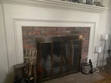

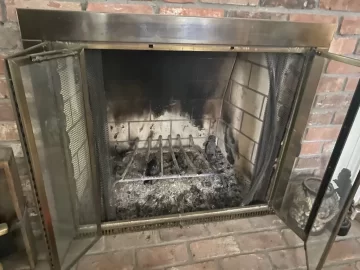

The opening is 33" wide brick to brick, 21 inches deep, and 27 inches wide in the rear, height is about 30"

That should be large enough to accommodate a medium-sized wood-burning insert or a pellet insert. Both have their pros and cons. Will the insert be used 24/7 for heating in the winter or more occasionally?

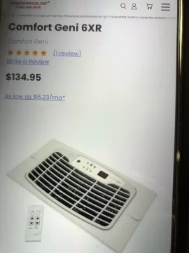

Here is the line sold by the dealer in Fairbanks. He has no complaints of them being noisy.
[Hearth.com] Advice needed - small room pellet or wood
Reactions: begreen
Thanks. That's a register booster but could work for the described in-wall ducting application. Amazon reports it is not available, but there are several other register boosters sold. AC Infinity sells this one.
