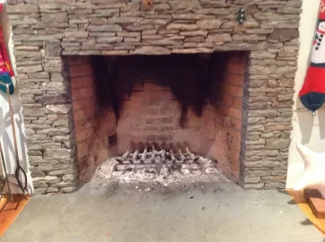

Hello all
First thank you for advice either way it comes but I have a fireplace in a newer built home 2008 pretty well insulated (spray foam) like to fill the hole with a better heating device rather than the warm air exhaust it currently works as
My home is sort of contemporary so I like the look of Osborn matrix but seems small for the size hole I need to fill
Was also considering installing a wood stove since measurement are 42" wide by 35 high to lintel and 23 deep and 29" wide at back wall
Thank you

Welcome. We'll need more info to help. First, tell us about the area you want to heat. With a foamed in house I am concerned about going large unless the house is already a big barn. How large is the house, how open is the floorplan? How tall are the ceilings.
Will you be burning this occasionally or 24/7? What is the current heat and how much fuel is used on average in December or January?
Sorry for all the questions at once. They will get the ball rolling quicker.

House is 3500sq
Very open floor plan
8' ceilings
Two flue fireplace one for this one and one for exterior fireplace
Side note is I have a large concrete cap on top of chimney is it possible to run liner from ground up?
Yes, the liner can be pulled from the bottom up when needed.
How is the home currently heated and do you have a rough idea how much fuel or electrons are burned in a cold month?
As a starter, take a look at the Blaze King Chinook 30 for a contemporary large stove that won't drive you out of the home. It's 35" tall, so double-check your measurements it might not fit.
