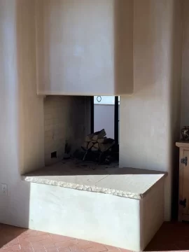

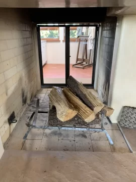

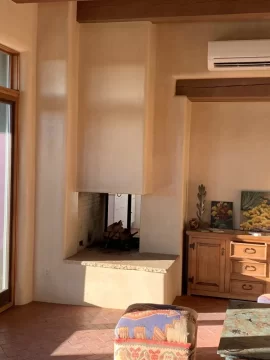

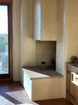

Hello!
We are under contract on a lovely home in Santa Fe, with a non-functional three-sided fireplace. We had it inspected and the chimney sweep recommended installing a woodstove in the fireplace after our failed fire test due to faulty design. I've read through the forums and am hoping someone here might have some advice about what might look good aesthetically and be functional in the fireplace.
I'm worried that a woodstove will sit so far back in the fireplace as to make loading it impractical because the wall serving as the mantle is at least a foot from the start of the firebox. And we'd have to either close off the back of the fireplace or you'd see the back of the woodstove in that room...
Another option would be a propane insert of some kind with custom glass doors on all three sides (is that even possible?) but we are worried that would be both cost prohibitive and not as warm as a woodstove. The house is about 1800 square feet and the other heat source are three mini-split units throughout, so we do want to use this as a heat source as well as for ambiance, but it's not crucial for heat and temperatures rarely dip too far below freezing here.
The Chimney sweep recommended the Kuma Aspen LE and the woodstove store salesman recommended the Rais Q-Tee II without base. The fireplace dimensions are 30" tall by 50" wide. I was thinking the Q-Tee could work if we put it in at an angle... or was thinking something totally different and funky like the Jotul F602 V2?
So my question is: what would you do, and do you have any suggestions for woodstoves that might work and be functional?
Thank you so much for your thoughts and help!

Couple quick thoughts. If you choose a wood stove I like the angle idea. I’m not any expert but I think it will need to be a rear vent stove. it is really neat design aspect, personal opinion here, is there another place in the room/ house that a wood stove might be a better fit as will really change the openness of the original design and limit stove choices.
A custom gas burner or off the shelf gas log set might look neat. Not sure it would need doors. Many fireplaces converted to gas don’t have them around here. Do you already have gas/propane? You could look into gas stoves. I personally like the look of the Jotul’s. Some of the modern designs fit better with the Santa Fe architecture better than the more traditional ones. Feeding a woostove for heat is a chore. If I had natural gas or propane I would have installed a gas stove. Burning for ambiance on a regular basis will be less of a chore but you could burn through wheelbarrow load in a weekend.

Thank you Evan! We have propane, and I'm leaning towards a conversion if we are investing in bringing this back up to function. Unfortunately the fireplace store here didn't really have much to offer in the way of custom gas burners and suggested that log sets wouldn't offer much in the way of heat. I think if we decided to go the log-set route (aka not too concerned about heat), we might test it out with a biofuel burner. One other suggestion was to just fix the chimney and install a fan at the top to help draw smoke up.

Right now the best bet seems to be installing a wood stove like the Rais Q-Tee II or a Stuv Cube STOVE (not insert, because as we know, there are no inserts that work for this kind of fireplace!) in the firebox. I was hoping for something like the Malm Carousel, but it's too large for the space. Ah well.
I see you are in Santa Fe and I agree that you might be best served by making it into a functional fireplace and just enjoy it whenever you want a fire. The stoves you are looking at will bake you out of the house and you would only be able to burn a bit of kindling before becoming uncomfortable. Gas logs aren't a bad idea, but the heat will escape through the chimney anyway or you will have a room vented set which have their own set of problems.

Is your house insulated? I know many CA houses are not. With poor insulation/air sealing a small wood stove might work, but a 600+ degree box in a living room sounds unappealing at 60 df outside temperatures.
Ethanol burners will have the same issues as the gas logs; water and other combustion products being emitted into your house.
Hi SpaceBus-- I live in Santa Fe, in Northern New Mexico. The house is pretty well insulated (built in 2009), but temperatures in the winter have an average high of 42 and average low of 17.

Well that certainly changes things! Go for the Rais, the Stuv doesn't have any user adjustment aside from load size. I suppose that can be an advantage for some.

@SpaceBus I agree, the vision / duet is a lovely looking stove. Unfortunately the dimensions don't work-- our firebox is about a 30" square and the Vision is 33" wide and 38" tall, the Duet is 36" wide.
Any thoughts on where I might be able to find photos of the BACKS of the Rais Q-Tee II and Novo stoves? It may come down as well to what looks *ok* with its rear end exposed...

You will probably have to contact the manufacturers or a showroom directly.

The back side opening could have perforated screening to disguise the rear view.
