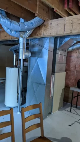

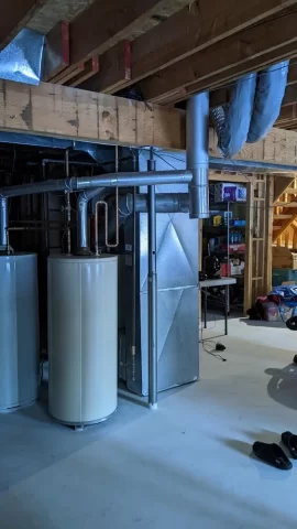

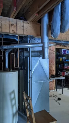

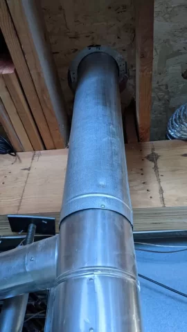

Was talking to a friend about wood stoves last night. He has a Regency, said it works well and he likes it. But several members of his family have Blaze Kings, either Prince or King models. He has convinced me this is the best stove to get. They are pricey, but the time saved in stoking the stove over years, plus being able to put bigger pieces in (less splitting, less bucking logs if longer rounds) maybe worth the higher up front cost of the stove. Thoughts on this rationale?
Deciding between the Princess and King for my use case, and application, but may be constrained by the chimney diameter of the stoves.
I have 11.5" clearance between my floor joists where I want to run the chimney pipe. I'm hoping I can somehow bevel out the joist by 1/2" to get to 12" clearance. Any ideas on this appreciated.
Its a double joist here, don't think missing 1/2" will have any structural risk.
Pics of where chimney would run, once the furnace/water heater venting is removed.
PXL_20221119_154424754.jpg PXL_20221119_154434785.jpg PXL_20221119_154459988.jpg PXL_20221119_154509617.jpg

I have 11.5" between joists where I want to run the stove chimney. I want to remove this furnace vent and run stove chimney in the existing chase.
A 6" stove pipe coming off Princess would require 10" space to allow for 2" clearance around the chimney?
Or do you have to add a double wall thickness to the 6" coming off stove? Meaning 12" space required for clearance?
6" class A chimney pipe is typically 8" in diameter and requires 12" space for clearance.
