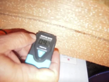

    Probably more guys have bought the Harbor Freight MM than any other on this site. I have one and it works well and is cheap. I think you have to buy it online.
    Here is mine in a piece of some dead standing Oak.

    Harbor Freight model (above) works great. It's cheaper to get it in the store (which I did) if you have one locally, to save shipping cost.
    P.S. These things are not rocket science...just an ohmmeter calibrated to read wood moisture. (The HF model also has a setting that lets you read moisture in plaster or sheetrock, to determine if you have moisture leaks behind your walls. Great to have when you're buying a house!)
